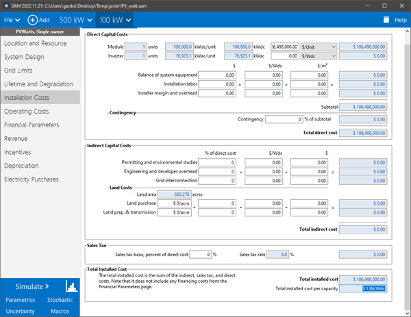

On the Installation Costs input page in SAM for the default PVWatts / Single Owner case, you can see that there are several cost categories that use the $/Wdc option. These are costs that SAM calculates based on the system capacity. These calculations are in the SAM user interface. They are not part of the PySAM Singleowner module. To make your Python script consistent with SAM, you could either simplify the inputs in SAM so that you use a single cost category to represent the total installed cost, or add the cost calculations to your script.
One way to to simplify the cost inputs in SAM is to use the Module cost to represent the system cost. For example, for the 100 MW system in your analysis, the total installed cost in SAM is $106,498,000.00 or $1.06/Wdc. You could set all of the cost inputs to zero except for the Module cost to zero like this:
I used the "$/Unit" option for the module cost and typed 106498000 for the input in SAM to make it consistent with the 'total_installed_cost' input to Singleowner in PySAM.
You can see the construction financing cost on SAM's Financial Parameters input page. The calculation is described in the Financial Parameters Help topic . For your analysis, you could either set the construction financing inputs on the Financial Parameters page in SAM to zero (and adjust the total installed cost accordingly), or you could calculate the construction financing cost in your Python script.
