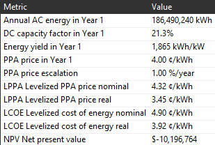

I’m getting different results in SAM and PySAM. This is a nexample for Pvwattsv8 with my own custom weather file. I only changed in SAM the system capacity to 100 MW, I generate the code to PySAM JSON and import it in Python. This works fine, with minor differences.
SAM results

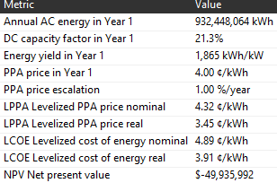

But when I change the system_capacity to 500 MW, I get quite different values for the LCOE nominal.
SAM results

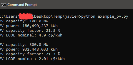

PV capacity: 100.0 MW
PV power: 186,487,766 kWh
PV capacity factor: 21.3 %
PV LCOE nominal: 4.9 c$/kWh
PySAM results
PV capacity: 500.0 MW
PV power: 932,435,679 kWh
PV LCOE nominal: 2.01 c$/kWh

print(f'PV capacity: {pv.value("system_capacity")/1000:,} MW')
print(f'PV power: {round(sum(pv.Outputs.gen)):,} kWh')
print(f'PV capacity factor: {round(pv.Outputs.capacity_factor, 1)} %')
print(f'PV LCOE nominal: {round(pv_so.Outputs.lcoe_nom, 2)} c$/kWh')
print('\n')
# Change capacity
capacity = 500 * 1000 # kW
pv.value('system_capacity', capacity)
# Execute and show results
execute_modules([pv, pv_grid, pv_ur, pv_so])

Thanks for checking. I'm getting same results as yours. The issue is the nominal LCOE provided by SAM is 4.89 c$/kWh, whereas it's 2.01 c$/kWh in PySAM, for the 500 MW PV plant, The 100 MW PV plant yields the same results in SAM and PySAM.
