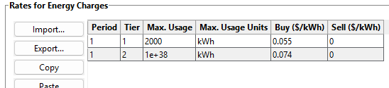

On the Electricity Rates page, you have specified the Net Energy Metering option for compensation of excess generation, which means that any excess generation is effectively being credited to the project at the retail buy rate. You mention that excess generation is "non sellable," so you should choose either the Net Billing option and set the sell rate in the energy charge table to zero.
Also, there is a mistake in the energy charge table: You have specified Period 1 and Period 2 in the table, but only Period 1 is defined in the Weekday and Weekend schedules. For a tiered rate with no time-of-use periods, you should specify Period 1 for both rows, and Tier 1 and Tier 2 for the Period 1 tiers like this:
