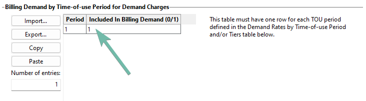

Thank you for emailing your file.
It took some investigation to figure what is happening here. It turns out that the billing demand calculations require that at least one period from the "Demand Rates by Time-of-use Period and/or Tiers" table be included in the "Billing Demand by Time-of-use Period for Demand Charges" table, even when the rates in the demand charge table are zero.
To fix the issue in your file, under "Billing Demand" on the Electricity Rates page set Included in Billing Demand (0/1) in the "Billing Demand by Time-of-use Period for Demand Charges" table to one for Period 1:
We will address this by adding a check to generate a simulation error when this happens: github.com/NREL/SAM/issues/1985
I've also attached a spreadsheet that shows how the lookback period works for a 11-month lookback period with 80% billing demand percentage for all months.
Thank you for helping us find this issue, and for your patience while we investigated.
