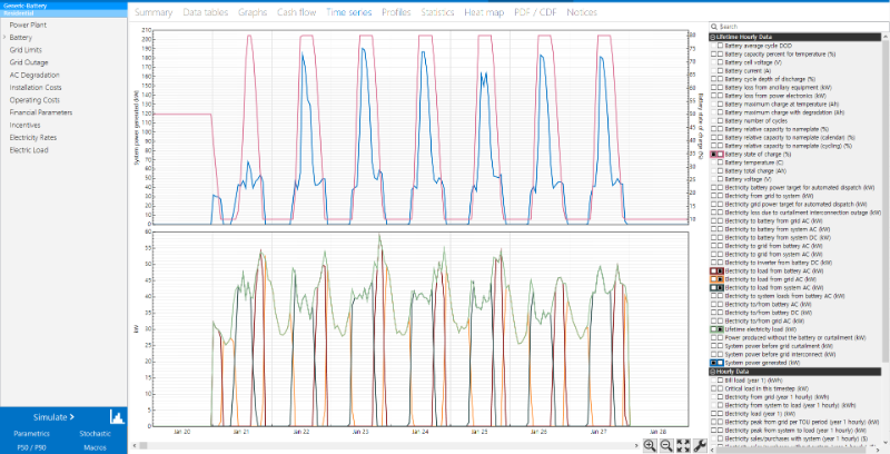

I compared the results of "electricity load" with 3 different options "electricity to load form battery AC", "electricity to load form Grid AC" and "electricity to load form system AC" in the time series. I can see from this graph which electricity (grid or system or battery) was used for the total power consumption. But if I compare this graph with "system power generated", I can see that the power generated is more than the amount stored in the battery. So is there any parameter that can tell me if the power generated by the system is stored in the battery and where the remaining power was used? If there is, please let me know.
And please give me feedback if my parameters chosen for comparing the results according to the battery operation options under the same conditions are correct! If there are any other parameters (result data) that can be shown additionally, I would be grateful to know.

Some of the power from the system may be going to the grid or to the battery. As I mentioned in your other post , SAM also models losses in the system and battery that may account for the differences.
