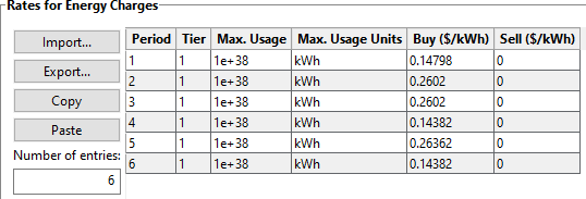

Are there any updates (
see this post
) to if the U.S. Utility Rate Database will be updated to reflect the NEM 3.0 rate structure? If we need to update the sell rates for NEM 3.0 manually, can you please advise on the process to do so?

In SAM, download the rate for your utility from the URDB, compare it to the rate sheet and make any corrections.
Then, set the Metering and Billing option to Net energy metering with $ credits:
Next, set the sell rate for each time-of-use period in the energy charge rate table to the appropriate export rate:
