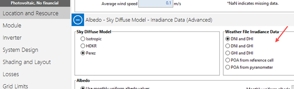

The table in the Weather Data Elements Help topic that I linked above shows that for the PV models, you need at least two of DNI, DHI, and GHI.
Use the options at the bottom of the Location and Resource page under "Albedo - Sky Diffuse Model - Irradiance Data (Advanced)" to choose which two components you want to use from the weather file:
