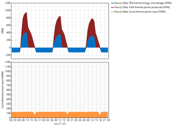

Hi Ahmed,
In each time step, when the value of "TES thermal energy into storage" is negative, it means that the TES is discharging power in that time step.
It might be helpful to use the time series graph to see how SAM is operating the plant. You can plot "Field thermal power produced" and "TES thermal energy into storage" to see the TES charging during the day and discharging at night. For example:

06 Sep 2022 11:43 #11423
Replied by Paul Gilman on topic CSP Thermal energy storage
Hi Ahmed,
The molten salt linear Fresnel model uses an older algorithm to solve for energy and mass flow and for plant control that performs poorly under certain conditions, especially during time steps when the solar field, thermal energy storage, and power cycle are all operating. This causes the error you found: On a total annual basis, it is quite small, on the order of 1%.
The molten salt power tower, physical trough, and standalone thermal energy storage models use a newer algorithm, so do not have this problem.
We hope to update the algorithm for the molten salt linear Fresnel model, perhaps in 2023, but are not sure if funding will be available for that work.
