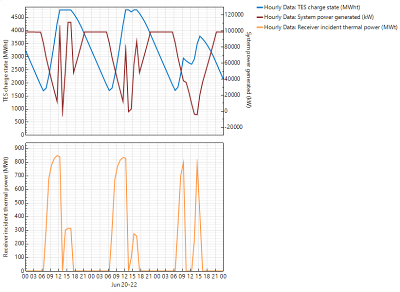

It might be useful to look at the "TES charge state" and "Receiver incident thermal power" variables in addition to the "System power generated" so you can see how the system is attempting to meet the turbine output fraction target with the available energy from the receiver and thermal storage.
For example, in this graph showing the days around the summer solstice, you can see that the system power generated follows the general trend defined by the turbine output fractions, but when there is energy from the receiver and storage is full, the system power exceeds the turbine output target.
Thank you for the additional information.
