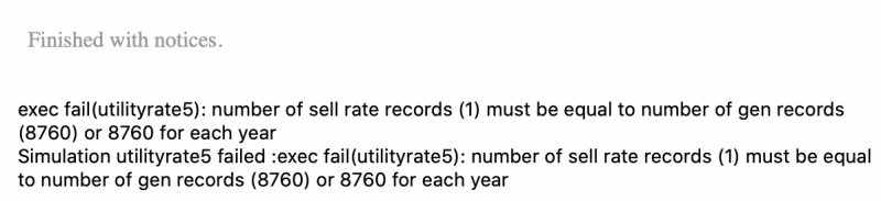

I believe that all the data that I entered/uploaded is hourly: 1) hourly TMY data - for calculating PV output, 2) hourly site load data - which I entered, 3) hourly net billing sell prices - which I enter, 4) hourly purchase rate data, which I selected from the database. Pretty sure everything is 8760 data points. But I am not a regular user of SAM and may be missing something obvious.
However, when trying to run a simulation, I get this error: "exec fail(utilityrate5): number of sell rate records (1) must be equal to number of gen records (8760) or 8760 for each yearSimulation utilityrate5 failed :exec fail(utilityrate5): number of sell rate records (1) must be equal to number of gen records (8760) or 8760 for each year"

Note that sales are based on hourly LMPs. The site has a generation so the load shows power going to the grid, even before adding PV.
I am pretty sure everything is hourly... so I am not sure why I am getting this error message. See the error message attached.
First, thank you for your help. I spent the day re-doing SAM... now I have the SAM program operating as it should and know where the .sam files are saved.
See attached for the sam file you requested a few days ago.

I thought I replied but I am not seeing it, here on the SAM website.
See attached for a run with the previously mentioned error message.
Thanks so much!!!
Niels
Thanks so much!!!
