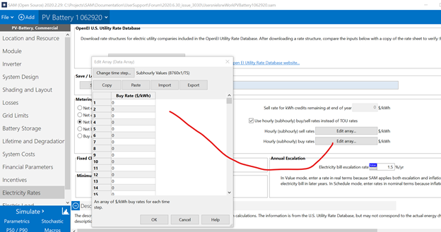

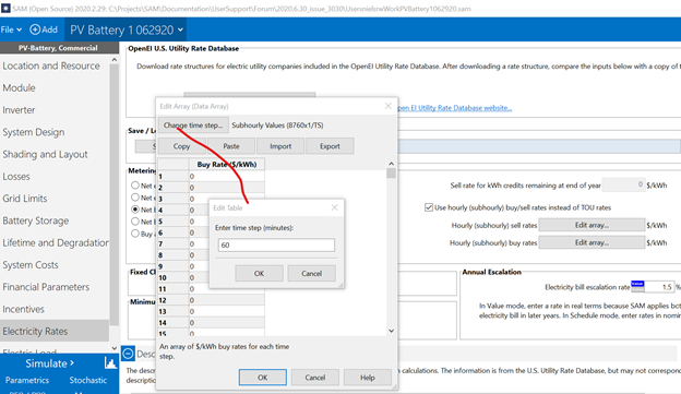

Niels,
The error you are seeing is because of the buy rates array in the UI which shows 8760 zeros.
However, the array that is used for the simulation is a single element array with one zero.
To fix the issue, either enter your own array of 8760 buy rates, or:
1. On the Electricity Rates page, click Edit array for hourly/subhourly buy rates.
2. In the Edit Array (Data Array) window, click Change time step.
3. Click OK in the Edit Table and Edit Array (Data Array) windows.
5. Click Simulate, and your case should run without error.
We will fix this issue in the next update to SAM and you can track progress at github.com/NREL/SAM/issues/343

When you check Use hourly (subhourly) buy/sell rates instead of TOU rates, SAM uses the time series buy and sell rates that you enter in the tables (by clicking Edit array) instead of the buy and sell rates shown in the table under "Energy Charges."
If you want to change rates that originally came from the URDB, you can change them in the Energy Charges table rather than replacing them with time series rates.

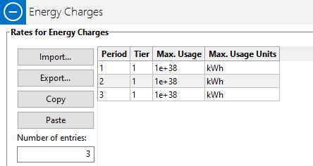

When you choose the "Net billing" option,
and check Use hourly (subhourly) buy/sell rates instead of TOU rate,
the energy charge table is disabled, which is why the buy and sell rate columns disappear from the table when you check the box.
So, for your application, you need to click Edit array under "Metering and Billing" for both sell and buy rates to specify the rates using the column of time series values instead of the tables under "Energy Charges."

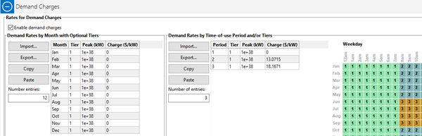

For demand charges, you can specify those under "Demand Charges." SAM calculates the energy charge and demand charge separately, so you should see the effect of the energy charge buy and sell and demand rates in the monthly bill.
