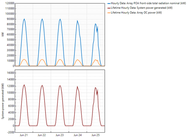

Hi Marty,
I'm not seeing that in my tests. Here are results for the Detailed PV model with weather data as I downloaded it using SAM's NSRDB download feature for "Delhi, India".
If you download data from the NSRDB website to use with SAM, be sure to check the Convert UTC to local time check box to ensure the resource data matches the time stamps for local time.
