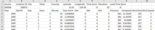

Here are the first few lines of a file with hourly data for a location in the UTC-8 time zone. The solar irradiance data is measured on the half-hour. The first time stamp is for 1/1/1999 0:30 local time, so the first row represents the hour ending at 1 am on January 1:

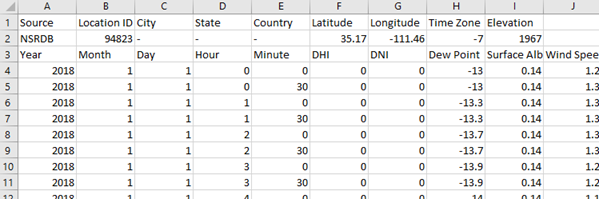

Here's another file from the NSRDB that contains 30-minute data for a location in UTC-7, with solar irradiance data measured at the top and bottom of each hour. The first time stamp is for 1/1/2018 0:00 local time, and the second for 1/1/2018 0:30. The first row represents the first half-hour of the hour ending at 1 am on January 1:
