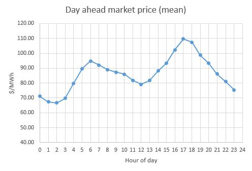

Hello all,
I have an issue using the automated dispatch option in a standalone battery - PPA single owner model. I am using version 2021.12.2 but thought that this thread would be appropriate for my post, please let me know if I should start a new one.
To simulate a utility BESS (50MW - 2h capacity) earning revenue only from energy arbitrage, I'm setting the PPA price=1 and TOD factors as multipliers instead of using the Merchant Plant ( see "Cleared capacity Merchant Plant" ). Choosing automated dispatch -> perfect look-ahead -> 24 hours period, the "profit" (= revenue - electricity_purchase ) was much lower than I would expect. The "Electricity to/from grid" time-series showed that the system realized one cycle per day, maybe even less on average. Looking at the average daily per-hour price of electricity, one would expect a 2h system to make two full cycles per day on average (cycle degradation penalty already set to 0).
So I switched to manual dispatch under the following scheme, which indeed raised the profit significantly.
