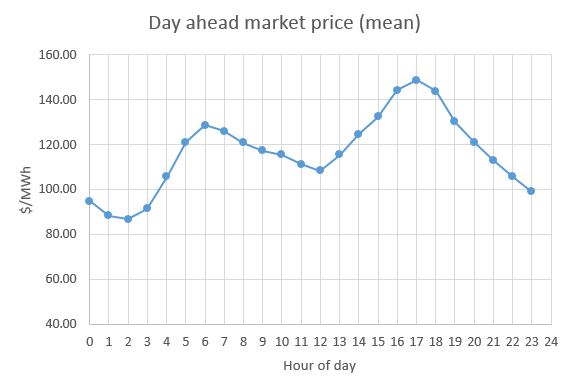

To simulate a utility BESS (50MW - 2h capacity) earning revenue only from energy arbitrage, I'm setting the PPA price=1 and TOD factors as multipliers instead of using the Merchant Plant ( see "Cleared capacity Merchant Plant" ). Choosing automated dispatch -> perfect look-ahead -> 24 hours period, the "profit" (= revenue - electricity_purchase ) was much lower than I would expect. The "Electricity to/from grid" time-series showed that the system realized one cycle per day, maybe even less on
average. Looking at the average daily per-hour price of electricity, one
would expect a 2h system to make two full cycles per day on average (cycle degradation penalty already set to 0).

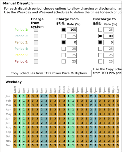

So I switched to manual dispatch under the following scheme, which indeed raised the profit significantly.

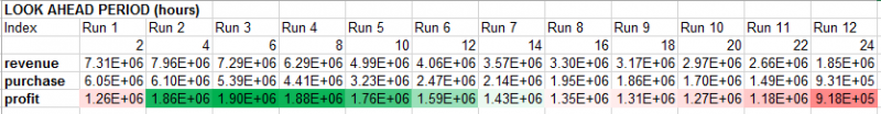

Not understanding why the crude manual dispatch gave better results, I returned to the automated dispatch running a parametric analysis with look-ahead period as the input and revenue, electricity_purchase as outputs. Results are shown below: a period of 6 hours gives the best outcome and from that point on any increase in the period gives a lower profit than the previous. The manual solution gave a profit of ~1.38E+06 (for reference).
From my understanding, higher look-ahead period should result in better optimized results but clearly this is not the case. Furthermore, changing the frequency to update dispatch variable gives exactly the same results. Am I getting something wrong here or is there indeed an issue in the algorithm?

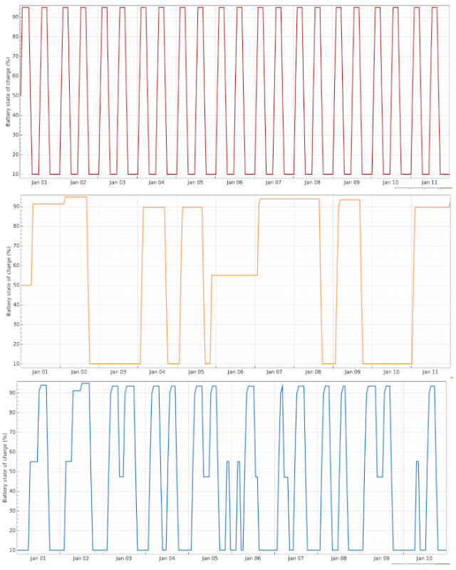

After Paul's suggestion, I include the SOC time-series for manual (red), auto24 (orange) and auto6 (blue) and attach the .sam file.

Replied by Paul Gilman on topic Battery Automated Dispatch (Version 2020.2.29)
Hi Alk,
The front-of-meter automated battery dispatch algorithm discharges the battery to meet a single peak over the look-ahead period. We are having discussions about changing this behavior, which you can follow (or contribute to) here:
github.com/NREL/ssc/issues/745
