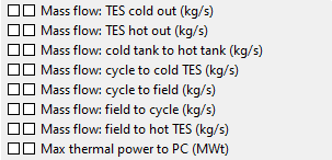

In the new version of parabolic Trough,
What is the exact definition of the output variables "Mass flow: field to hot TES" and "Mass flow: cycle to cold TES"? I understand that they are the HTF mass flows leaving the cycle to the cold tank and from the field to the hot tank respectively, but I do not understand why "Mass flow: field to hot TES" is the same amount as "Mass flow:TES cold out" and "Mass flow: cycle to cold TES" is the same amount as "Mass flow: TES hot out"
Thanks so much
