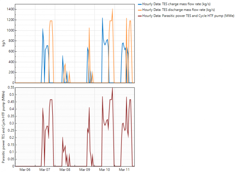

In SAM, when the solar field heat transfer fluid (HTF) is different from the thermal energy storage (TES), the TES is modeled as indirect storage, which is defined has having a storage medium that is different from the field HTF. The "HTF" may be an oil or a salt.
If you are modeling a system with molten salt as the storage medium, then the TES HTF mass flow rate refers to the molten salt.
The "Parasitic power TES and Cycle HTF pump" is the sum of pumping power required by the TES and cycle, determined by the "Pumping power for HTF through storage (kJ/kg) input on the Thermal Storage page and "Pumping power for HTF through power block (kW/kg/s)" on the Power Cycle page.
I created the following graph by setting the cycle pumping power to zero to show how the TES pumping power relates to the TES mass flow rates:
