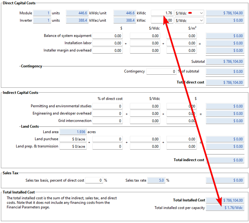

Hi Seif,
You found a tricky part of comparing SAM and PySAM results.
The main issue is that the total installed cost in SAM is calculated by code in the user interface that is not part of PySAM. One way to fix this problem is to use the module cost input on the Installation Costs page in SAM to specify the total installed cost in $/Wdc. This requires setting all of the other inputs on the Installation Costs page to zero. For example here I set the total installed cost to $1.76 W/dc so that the input and the blue calculated value are the same:
Then, in your Python script, you'll want to set the total installed cost:
financial_model.SystemCosts.total_installed_cost = nameplate_capacity * 1000 * 1.76
