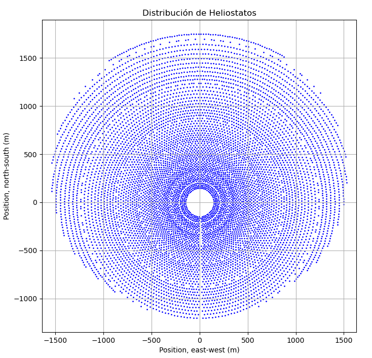

I am trying to create a scenario slightly different from the default configuration of SAM for CSP Tower Molten Salt without a financial model (a.k.a. "No financial" in PySAM). For this, I used the attached Python script.The problem arises when I simulate the scenario and plot the heliostat field. The results do not look correct; in fact, they look very bad. I am unsure if I assigned an incorrect value to a variable.I have also attached the weather data, which is one of the official SAM datasets.I have identified the optimization setting in the Python script with a comment. The variable responsible is called

If you run your script, you will get a field with the maximum allowable number of heliostats given the default boundaries for the SolarPILOT optimization algorithm, which results in the receiver under-performing:
Because these default boundaries scale with tower height, you could solve this problem by increasing the tower height. Or, you could use the field optimization method (field_model_type = 0), which will optimize the tower height, receiver height, and receiver diameter using a cost and performance objective:

Hi Ricardo,It looks like the issue might be related to the default boundary constraints set for the SolarPILOT optimization algorithm in PySAM. Since these boundaries scale with tower height, the field model may be generating a suboptimal heliostat arrangement, causing the receiver to underperform.Suggested Fixes:
- Increase Tower Height – Adjusting this parameter should help improve the field layout and receiver performance.
- Use Field Optimization Method – Set 'field_model_type = 0', which allows the system to optimize tower height, receiver height, and receiver diameter based on cost and performance objectives.

I increased the tower height but still encountered the same problem. I changed the height to 300 to confirm that the issue is not related to the height. I also tried using the method with 'field_model_type = 0', but that didn’t seem to work well either.
Could the issue be related to the "No financial" model and the default case 'TcsmoltenSalt.default("MSPTNone")'? Could it be that SolarPILOT requires a variable that is not being assigned?Could you provide me with a 'requirements.txt' file so I can try running my script with your environment? Maybe I’m facing a library compatibility issue.

Hi Paul and John,Thanks for everything. My issue was the version, everything looks good with PySAM 6.0.0. Thanks again!
