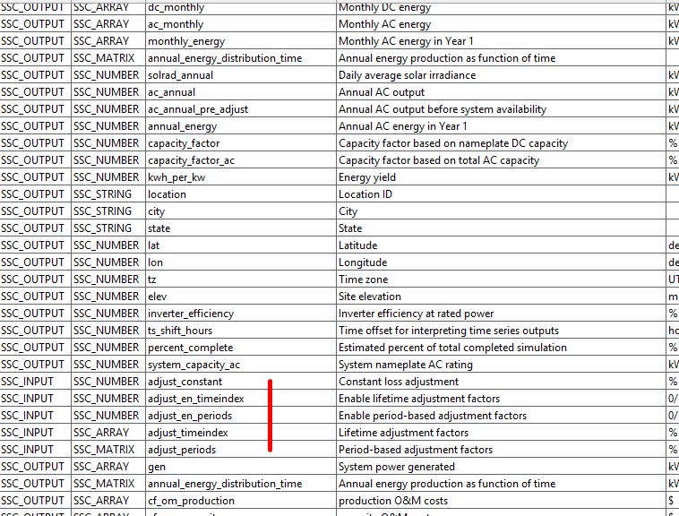

The likely cause of the difference is that the PVWatts V8 API is using different weather data than your C# code.
SAM 2024.12.12 uses SSC Version 298. For that version variable 'adjust:constant' should be 'adjust_constant'. (Older versions use a colon ':' in the 'adjust' variable names, and newer versions use underscore '_'.).
You can use SDKtool program that comes with SAM 2024.12.12 to see a complete list of inputs and outputs for the pvwattsv8 module. For more about SDKtool, see sam.nlr.gov/software-development-kit-sdk.html .
