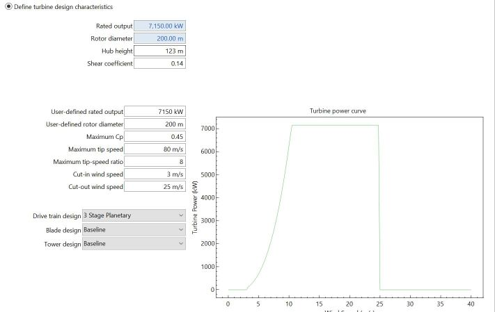

Please help me to solve the problem with the wind turbine model.
When I build a wind turbine model, firstly I use the SAM software and select "Define turbine design characteristics". The parameters are shown below:
Then, I can get a power curve of the turbine. However, when I use the function "calculate_powercurve()" in PySAM, the power curve generated by PySAM is different. The attachment is the details of two power curves.
Therefore, I can't find the reason why the two curves are not same. I hope you will be able to help me. Thanks!

Replied by Paul Gilman on topic Wind turbine power curve problem
Hi Junchi Ma,
It may be possible that the inputs to the PySAM 'calculate_powercurve()' function are different from the inputs in SAM.
Please provide an example of Python code you are using to set the inputs to 'calculate_powercurve()' if you would like me to help troubleshoot.
