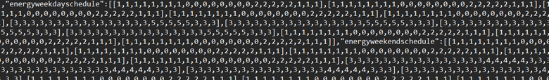

Inspecting the JSON file, "energyweekdayschedule" is definitely populated.
It is also the appropriate size (12x24) and type (sequence[sequence]) as the ur_ec_sched_weekday key defined in the Utilityrate5 documentation, so I assume this is what get's mapped to the "ur_ec_sched_weekday" when ur.value(key, val) is executed.

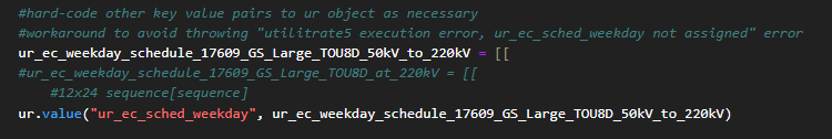

I will try hard-coding the energyweekdayschedule, through something like
That method is prone to input error though!

Note that your hardcoded workaround does not account for the fact that the URDB data is indexed to zero while SAM data is indexed to 1, so it will likely cause downstream errors in the Utilitityrate5 module.
As far as we know, the URDBv8_to_ElectricityRates() should be working correctly.
Could you attach a copy of the JSON rate data you are working with so we can investigate?
