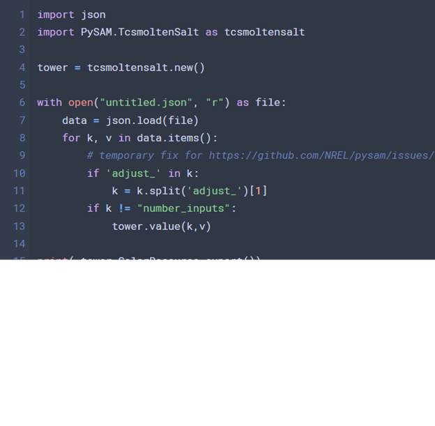

Thanks for your reply, I should have mentioned that I first started by trying the value() function with the temporary fix but had no luck so was trying the assign() function. I am getting an unnamed attribute error when trying to run the code in your reply. For testing purposes I just generated the" JSON for inputs" as "untitled.json" for the default CSP Tower Molten Salt Single Owner model from SAM 2023.12.17 GUI.
Edited 6/5/2024: Note that the workaround should use replace() instead of split():
The line
should be
The line
k = k.split('adjust_', '')
should be
k = k.replace('adjust_', '').
Last edit: 05 Jun 2024 17:00 by Paul Gilman. Reason: Please attach images as files and then insert them into your message

Hi Evan,
Part of your screenshot got cut off -- it's best to attach images as files and then insert them into your message. Cutting and pasting images into the editor does not work reliably.
Please check that you are using PySAM 5.1.0, using the "PySAM JSON" option to export the inputs, and using SAM 2023.12.17 r1.
If you continue to have trouble, please attach a copy of the JSON file (please zip it before attaching if you get a message about file type).
