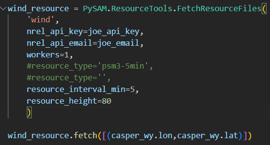

I am trying to use the ResourceTools module within PySAM to download resource files for wind and solar, to eventually use in PySAM modeling. Specifically, I want to pull wind resource files with a 5-minute time resolution using the code at the end of this post. Based on the documentation here , I have tried to use both 'psm3-5min' and an empty string as the resource_type argument, and I've also tried leaving that argument out. In any case, it still downloads the data at a 60-minute resolution instead of 5-minutes.
Is there a way to get 5-minute time resolution files from the WIND Toolkit using FetchResourceFiles?
Thanks!
Thanks!

Thanks for your response. I tried your code, and copied it over below in case there is a mistake I am not seeing. I am still not able to get 5-minute profiles for wind. Is your tools object an instance of PySAM.ResourceTools? I'm assuming that the email and API key are working because it does download a weather profile, but even with the time set to 5 minutes, the file only contains 8760 data entries. Is there something else I might be missing?
Thanks!
Joe
