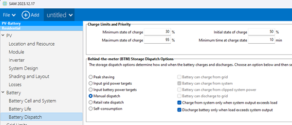

Second question is I saw the presentation with self-consumption dispatch which is not available in the stable release, would this be available anytime soon ? Is there a way I can experiment with this algorithm ?

The Self-consumption dispatch option is available for behind-the-meter batteries in SAM 2023.12.17:

We just released SAM 2023.12.17 that includes the new battery dispatch option for self-consumption.
The battery_target_power input only applies with the "input battery power targets" battery dispatch option. For this option, you provide the target battery power (negative to charge the battery, positive to discharge) in each time step and the model attempts to operate the battery according to the target power values.
