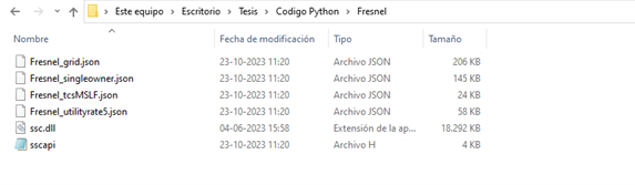

The file names are these ones:
And it gives me the next message:
