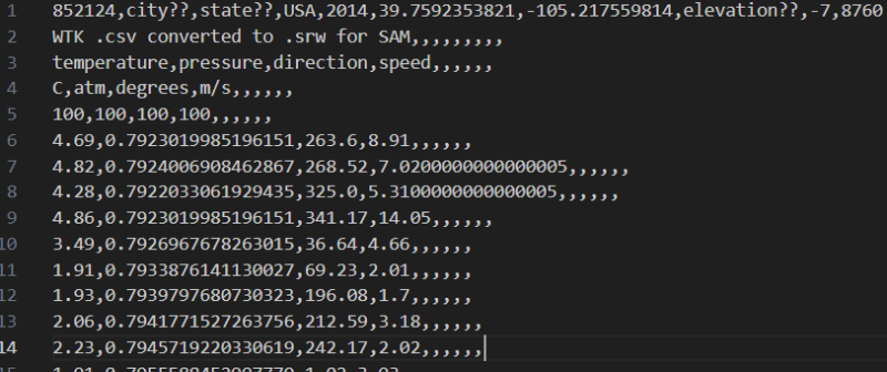

When following the documentation example for PySAM.ResourceTools.FetchResourceFiles (
github.com/NREL/pysam/blob/main/Examples/FetchResourceFileExample.py
), the script successfully downloads the wind SRW file, but fails to execute the Windpower module. I receive the following error (using PySAM 4.1.0):
Exception: windpower execution error.
exec fail(windpower): failed to read local weather file: number of columns in header line 5 must match line 3: 4 required but 9 found
I've attached a screenshot of the SRW file in question.
I do not encounter the same issue with downloading solar files and executing the PvWatts module.
As a workaround, converting the SRW file to a wind data dictionary (ResourceTools.SRW_to_wind_data) and assigning that to the 'wind_resource_data' variable seems to work (at least in this example). Is there something more obvious that I'm missing when downloading the SRW files and trying to execute them directly, or should I be converting all of them to data dictionaries as above prior to executing the Windpower module? If the latter, is there a similar way to do this in PySSC (currently use 'ssc.data_set_string( data, b'wind_resource_filename', bytes(wtk_fp, encoding = 'utf8')), but not finding anything in a quick search of the documentation for setting resource_data this way)?

07 Jul 2023 17:46 #12291
Replied by Paul Gilman on topic Error Executing Windpower Module with Downloaded SRW Files
One quick thing to try is removing the trailing commas from the end of each line in the SRW file.
Let me know if that does not work and I will investigate further.

- S. Lowder
10 Jul 2023 08:57 #12301
by S. Lowder
Replied by S. Lowder on topic Error Executing Windpower Module with Downloaded SRW Files
Thanks for the quick response. Stripping the trailing commas seems to work; just didn't expect to have to do that since in previous PySAM releases that co-workers use it isn't necessary.
Thanks again and no need for further investigation.
