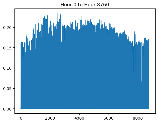

When performing a simulation with every hour in the weather file, the models works fine.

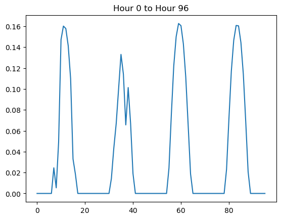

When I perform a simulation for the first 96 hours in the weather file, the models also works perfectly.

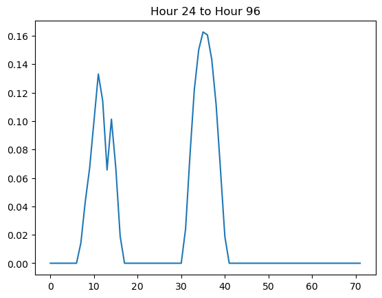

However, when I perform a simulation from hour 24 to hour 96 in the weather file, the models yields different results as the output from hour 72 to hour 96 appears to be missing.

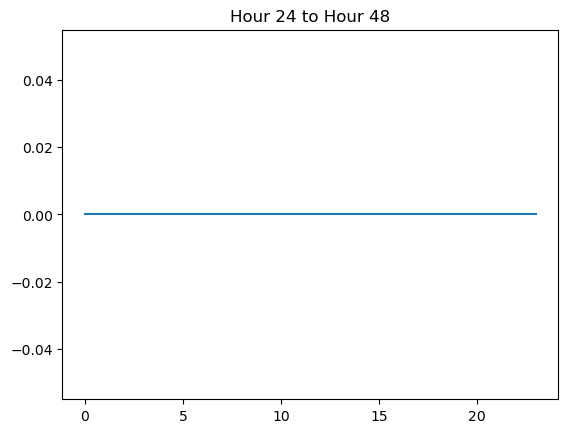

Also, when performing a simulation from hour 24 to hour 48, the output of the simulation is zero for every hour.

plt.plot(simulate_hourly_generation(0.3, 0, 180, weather_file_data, weather_file_meta_data))
plt.title('Hour 0 to Hour 8760')
plt.show()
plt.plot(simulate_hourly_generation(0.3, 0, 180, weather_file_data[:96], weather_file_meta_data))
plt.title('Hour 0 to Hour 96')
plt.show()
plt.plot(simulate_hourly_generation(0.3, 0, 180, weather_file_data[24:96], weather_file_meta_data))
plt.title('Hour 24 to Hour 96')
plt.show()
plt.plot(simulate_hourly_generation(0.3, 0, 180, weather_file_data[24:48], weather_file_meta_data))
plt.title('Hour 24 to Hour 48')
plt.show()
