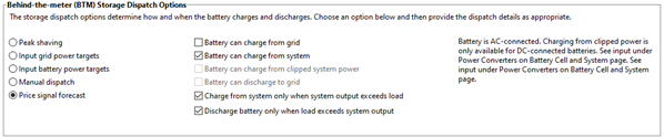

In this case, you can see from the disabled inputs for the Price Signal Forecast dispatch option on SAM's Battery Dispatch page for a behind-the-meter battery that charging from the grid is allowed, but discharging to the grid is not allowed. The text to the right of the inputs provides some additional information:
