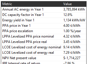

I am running pvwatts8 using pySAM for multiple locations in my study area. I've run into an issue where the LCOE output does not reflect the output when running the same location and system size in the GUI of SAM. Below is the code I am using, picking just one location the weather file used is for 41.712 latitude and -72.358 longitude. The code below returns a LCOE of 74.42 cents per kWh where as the GUI of SAM returns 7.29 cents per kWh. The system nameplate kWdc capacity is 3338 with a grc of 0.37. Any help understanding this discrepancy is much appreciated.

Hi Adam,
The most likely cause is that the inputs in your .sam file are different from the inputs your Python code is setting.
If you would like me to help troubleshoot, please attach a copy of the .sam file you are using for this comparison and a copy of the weather file you are using.

Hello Paul,
Thank you for getting back to me. When I first ran SAM against pySAM I only adjust the same parameters so they should be identical as I mostly rely on the default values however there could be a discrepancy I am unaware of. Attached are the two .SAM files that I used for a test and the associated weather file. Thank you again for providing assistance with this.
I've also included the csv I use as inputs for my pySAM code.
Adam
Adam

Hi Adam,
There is a difference somewhere in the default input values for the Single Owner financial model between PySAM and SAM. The PySAM and SAM defaults are stored in different files, so it is possible that the current PySAM defaults are for an older version of SAM. We will try to track that down and fix it.
The best way to ensure you get the same results from SAM and PySAM is to export the input data from a SAM file to "JSON for PySAM " and then import the JSON data into PySAM. That gives you better control over the PySAM input data than relying on the defaults. Those steps are described in the PySAM documentation here: nrel-pysam.readthedocs.io/en/master/Import.html .
I did that for your Test_SAM_1.sam file and use the attached Python script to verify that the results from SAM and PySAM are the same. The NPV metric is a better metric than PPA price for testing the financial model because by default the PPA price is an input set on the Financial Paramters page:
Here are the steps I followed:
