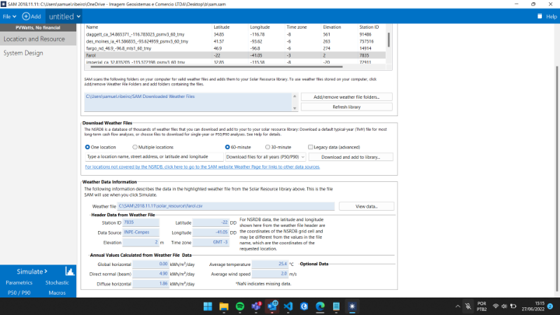

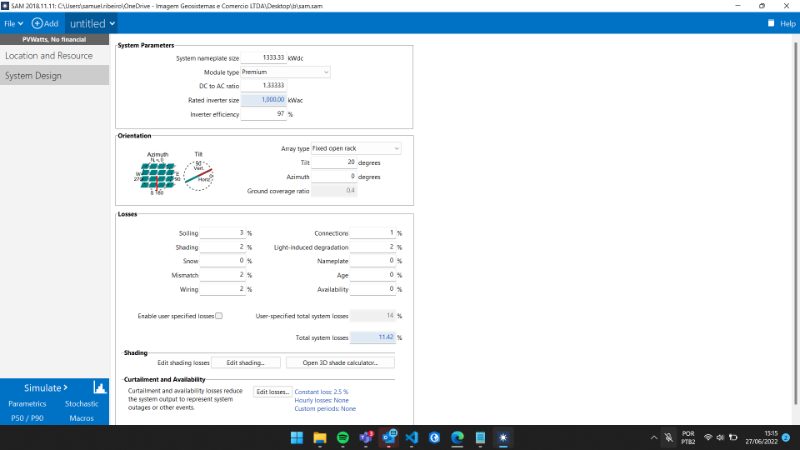

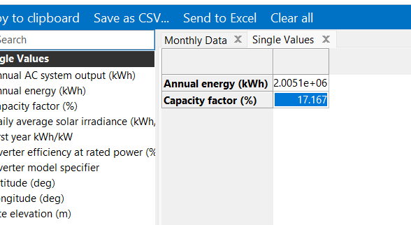

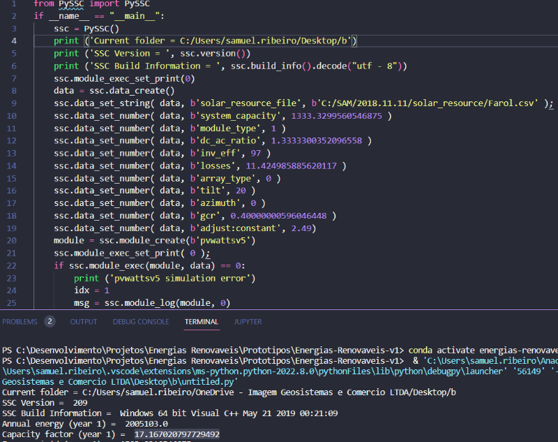

Hello, I'm currently using PySAM (Pvwattsv5) and I'm having different output values than SAM (2018.11.11) with no financial model using the in attachment. By SAM I generated the Python code (PySSC) and in it I have the same output values as the application, but using the same input values of the code generated in PySAM I having values are a little different.
Output SAM:
Output PySSC (genered code):
