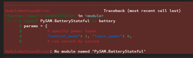

Dear Support,
I'm a new user in using PySAM for battery storage, so kindly request to bear with me,
Started with the jupyter-notebook and found this sample file from the Storage Webinar recently held. This is the import error I'm getting,
I've reattached the file for your convinience!
PS. I'm a windows user,
Jawwad
Jawwad

Hi Jawwad,
I think you need to install the Development version to access that module: pip install nrel-pysam==2.1.5.dev3.
I added that to the supporting materials with the webinar recording at sam.nlr.gov/software-development-kit-sdk/pysam.html .

Thanks for that,
It worked!
Sorry for missing the detail,
Thanks again!
Best,
Jawwad
