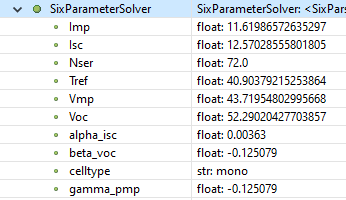

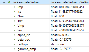

I initiate a new instance of the module with SixParsolve.new(). To define the parameters for this I use:
SixParsolve.SixParameterSolver.Imp
SixParsolve.SixParameterSolver.Isc
SixParsolve.SixParameterSolver.Nser
etc.
My inputs before running the execute command are as follows:
It worked fine for inputs like this so i'm not sure what the issue is.

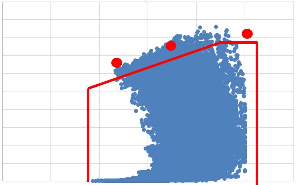

What i'm basically trying to do is apply inverter input limits so that i know how the inverter would clip the input. SAM's clipping method does not take into account the inverter max current so this is why I need to develop my own method. I'm trying to generate the IV curve to be able to know where the operating point would be if for some points they lie outside the inverter envelope. For example, lets say the y-axis is Pdc and x-axis is Vdc for the PV panel and when I connect the inverter I want to know where the new points will be. The only way to truly know where they will move to is if I have the IV curve of each point. The red is the inverter envelope and the 3 red points are some of the blue points that lie outside the inverter envelope. I want to find all the IV curves for all the points outside this envelope so i'm trying to generate the diode parameters SAM uses but for some of the points that lie outside this envelope i'm getting an error when I run the SixParameterSolver module as stated above.

Please attach the images you would like to include in your post as files, and then insert them into the message. Cutting and pasting images into the editor does not work reliably. I was able to recover two of the images you posted, but not the third showing the inverter limits.
Anyway, I think I understand what you're trying to do. The Six Parameter Solver sometimes cannot converge on a solution. It was written to work with parameters under design conditions at STC, so I don't think it is guaranteed to work under the full range of operating conditions. For example, in the the second example in your post has a low Tref value, which might be causing the error.

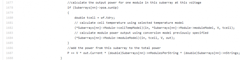

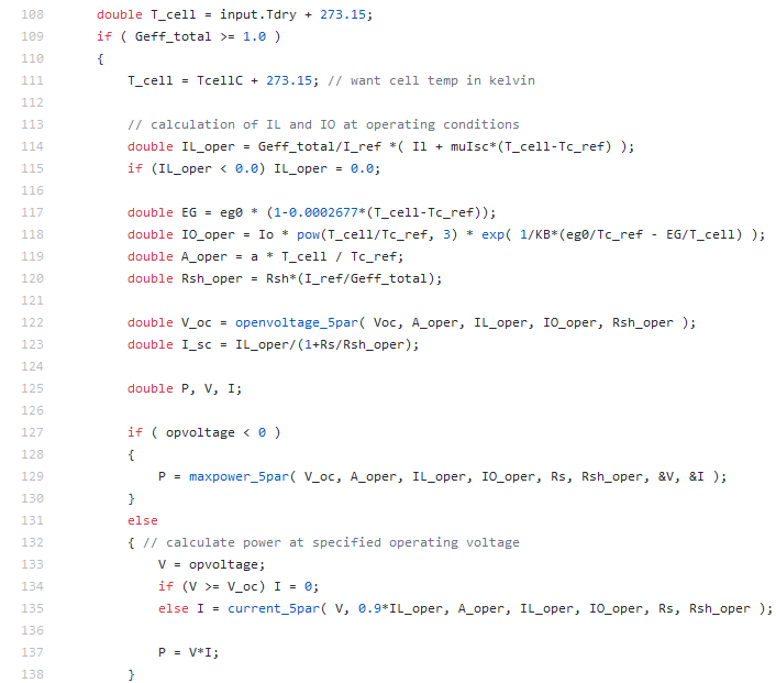

The code that performs these calculations is in ssc/cmod_pvsamv1.cpp (around Line 1677 at the moment) at github.com/NREL/ssc/blob/develop/ssc/cmod_pvsamv1.cpp :
And in shared/lib_cec6par.cpp at github.com/NREL/ssc/blob/develop/shared/lib_cec6par.cpp :
Functions involved in these calculations are also in shared/lib_pvmodel.cpp at github.com/NREL/ssc/blob/develop/shared/lib_pvmodel.cpp .
