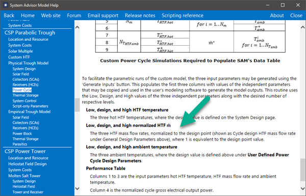

What does [ND] in m_dot_htf [ND] mean?

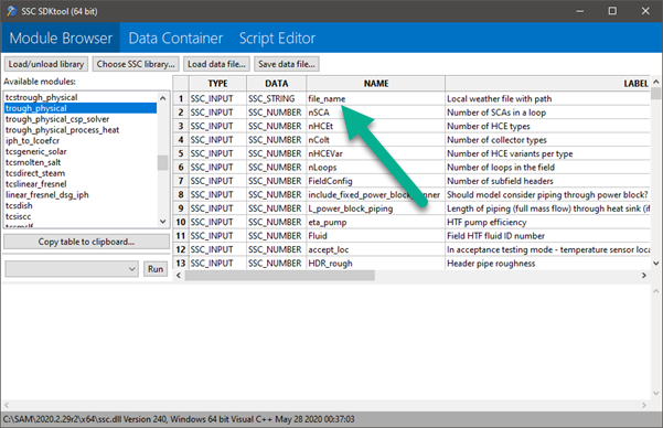

Also, I have observed in line 35 that says "Local weather file with path". Is this true for all, like the file path must be written in the code? or is there another way so that we can write only the file name of the weather file in the code?

08 Jun 2020 10:31 - 08 Jun 2020 10:32 #8285
Replied by Paul Gilman on topic troughPhysical
Last edit: 08 Jun 2020 10:32 by Paul Gilman.
