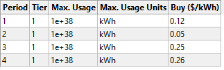

To assign values as they appear in this screenshot of the energy charge input table in the SAM user interface,
the 'ur_ec_tou_mat' array would be defined as (with line breaks and spacing to make it more legible):
To assign the buy rate for Period 1, Tier 1 to $0.10/kWh, you would set:
So, that part of your assignment looks correct.
ur_ec_tou_mat =
[ 1, 1, 1+38, 0, 0.12, 0 ],
[ 2, 1, 1+38, 0, 0.05, 0 ],
[ 3, 1, 1+38, 0, 0.25, 0 ],
[ 4, 1, 1+38, 0, 0.26, 0 ]
ur_ec_tou_mat[0][4] = 0.1
