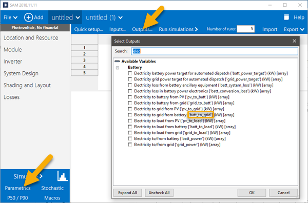

Hello, I would like to get a results for hourly 'Electricity to grid from battery (kW)' and hourly 'Electricity to battery from PV(kW)'. I would like to use ssc.data_get_array(data, b'XXX') and wonder what are the XXX for the aforementioned data.

Hi James,
One way to find the SSC variable names for SAM variable labels is to use the Parametric simulation output variable list:
- In SAM, open or create a case for the kind of system you are modeling using the SDK.
- Click Parametrics (under the Simulate button).
- Click Outputs at the top of the Parametrics page.
- Use the Search box to filter the list of output variables available for that case.
