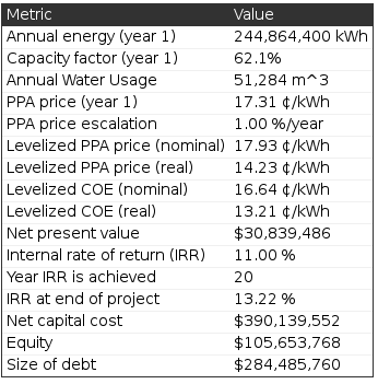

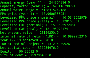

Hello, I'm new to the SDK. I notice that the results of the financial model are different when calculated with the Desktop version or with the code generated by SAM 2018.11.11 itself (I tried with Python 2, Python 3, and Matlab). For example, the size of debt value is 284 millions for the desktop version, but 259 millions for the generated code. Can anyone explain me why this is happening?

Thank you for your answer! After a few investigations, the problem seems to be different rounding errors between SAM and the generated code. I have to say that I have no idea of how to solve that issue.

- Anton Driesse
- Posts: 19
17 Jun 2019 09:18 #7460
by Anton Driesse
Replied by Anton Driesse on topic Differences of results between the desktop version and the SDK one
Actually, the "PPA price (year 1)" looks quite different.
