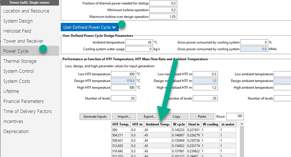

Hello, I'm new to the SDK. I generated Python 2 code from the SAM Desktop application (version 2018.11.11) and I'm trying to match the variables with the GUI of the desktop version. I'm struggling to find what "ud_T_amb_ind_od" is. Can anyone help me with this issue?

The ud_T_amb_ind_od is a variable that appears on the Power Cycle input page's User Defined Power Cycle option for the Molten Salt Power Tower model in the part-load or "off design" table's Ambient Temp column:

Thanks you a lot for your answer, I understand better now. Sorry for my lack of precision, I'll keep in mind to specify more information for a next time.
EDIT:I was thinking, maybe is there a manual available online explaining the correspondence between the generated code and the GUI? I look up a little on Google but I couldn't find anything but dead links. I just found the option File > Inputs browser... that shows this information.
