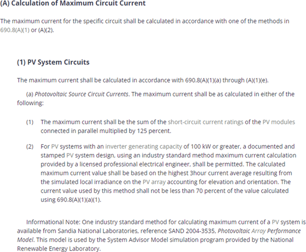

Anyway, I found this link to a copy of that section of the NEC code here up.codes/s/circuit-sizing-and-current and attached a screenshot of the text as an image:
I am curious about the source of informational note that mentions SAM. It references the documentation of the Sandia Module model, but does not explain how to use the model for this purpose. The Sandia Module model is available in SAM by choosing the option at the top of the Module page, but it does not have an up-to-date library of modules.
If necessary, SAM does adjust the array voltage to prevent the array power from exceeding the inverter's power rating. SAM does not report the DC current, but you can calculate it by dividing the "Inverter DC input power" by the "Inverter MPPT 1 Nominal DC Voltage." SAM does report the "Subarray 1 short circuit DC current." You can find these variables by filtering the lists on the Data Tables or Time Series tabs of the Results page using the terms "voltage" and "current."
