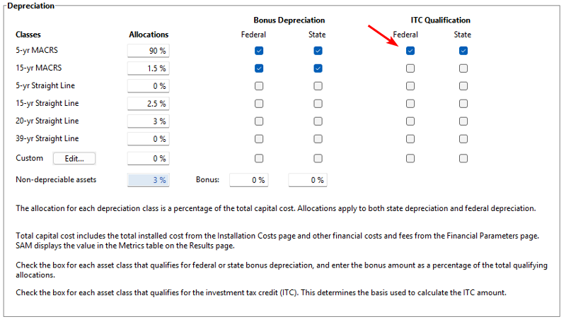

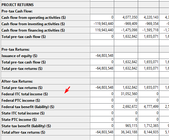

I entered a 30% State ITC in the incentive page but after the simulation run I don't see that dollar amount in the cash flow spreadsheet

The tax credit income, including for the Federal ITC is reported in the "Project Returns" section of the cash flow under "After-tax returns":

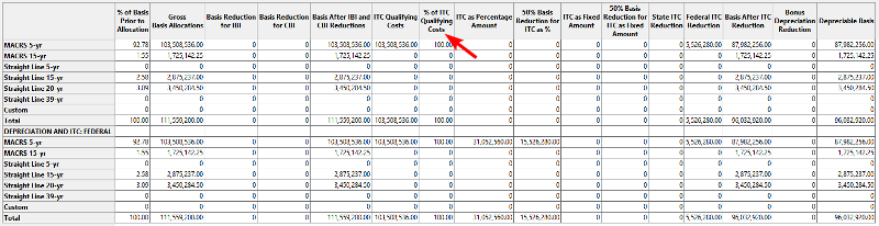

The portion of the total installed cost that qualifies for the ITC is in the table below the cash flow:
Note that the ITC qualifying costs are determined by the check boxes on the Depreciation page.

I overlooked the Depreciation Page check mark requirement. Thank you that worked!
