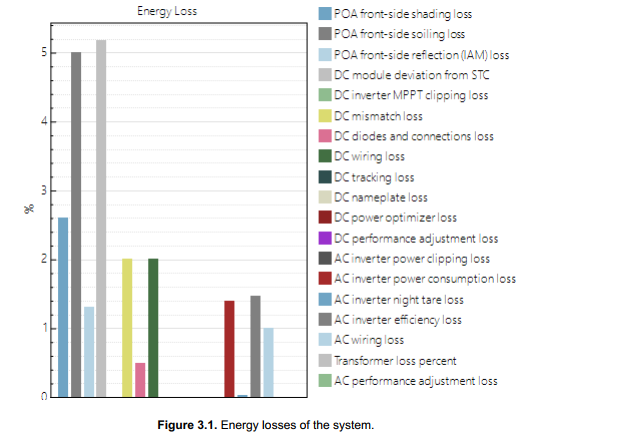

In the photovoltaic section, after simulation, there are a series of charts in the summary. I want to add a very important chart (Energy losses) that was available in previous versions but is not there now. How can I do this?
I can create this chart in the "graph" tab, but every time I do this, it takes a lot of time. Can you help me figure out how to do this once so that the chart is always available in the Summary section? I would really appreciate your guidance.

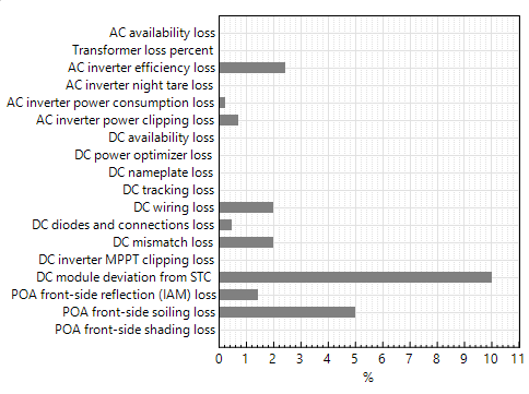

However, you can write an LK script to create a similar graph. For example, I used the attached plot-detailed-pv-losses.lk script to create the following plot:
The script displays the plot in a window and then exports the plot as a .png image file.
