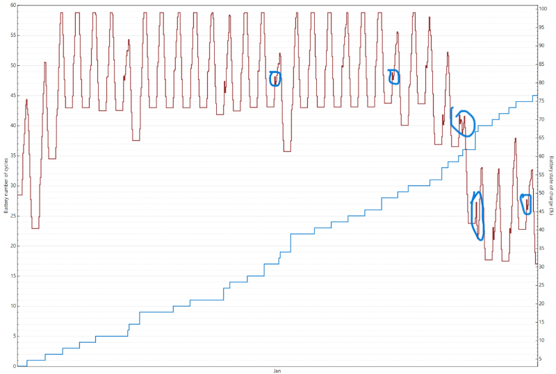

The Issue: I am seeing a large discrepancy in cycle counts. My system throughput is roughly 100 MWh/day, which implies ~0.25 Equivalent Full Cycles (EFC) per day. However, SAM reports approx. 45 cycles for the first month (approx. 1.5 cycles/day).
Question: I understand SAM uses the Rainflow cycle counting algorithm. Is it normal for the Rainflow method to produce a count this much higher than a standard throughput calculation?

Hi Tanatip,
Yes, the rainflow algorithm is counting cycles correctly, and the higher cycle count than standard throughput is how we expect the algorithm to work.
We’ve circled a few cases in your plot that show more than one cycle per day:
This raises the question of how best to implement a manufacturer’s degradation curve in SAM's cycle degradation algorithm. We’d expect a rainflow degradation number to have 4-6x the number of cycles relative to full equivalent.
