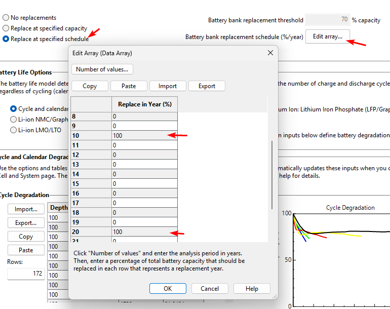

Hello everyone,I am working on a research project where I need to model multiple full calendar-life cycles of a lithium-ion battery within a single SAM simulation.
Conceptually, the goal is simple:
Then I used “Replace at specified schedule” (year 10) expecting the lifetime state to reset to 100 %.
However, after the first 100→80 % decline, the overall lifetime degradation simply continues downward across the entire project horizon (20–25 years).
It does not restart at 100 % after replacement.(2) Multi-cycle calendar table (“reset points”)I also tested a more explicit multi-cycle calendar table:

- define replacement years (e.g. year 10 and 20),
- have SAM treat each new battery as starting again at 100 %,
- show a new independent 100→80 % degradation cycle,
- and have this behavior visible in the final SoH output?

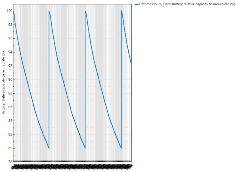

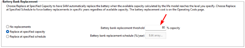

The attached battery-replacements.sam file contains two PV-Battery / Residential cases that compare the "replace at specified capacity" and "replace at specified schedule" options on the Battery Life page.
The "replace at 80%" case replaces the battery when its capacity degrades to 80%.
This results in the battery being replaced three times in the 25-year analysis period:
The "replace every 10 years" case replaces the battery every 10 years, regardless of the battery capacity.

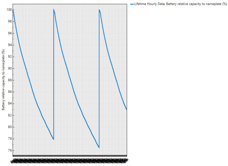

This option results in two replacements over the 25 years, with the battery degrading to less than 80%:
