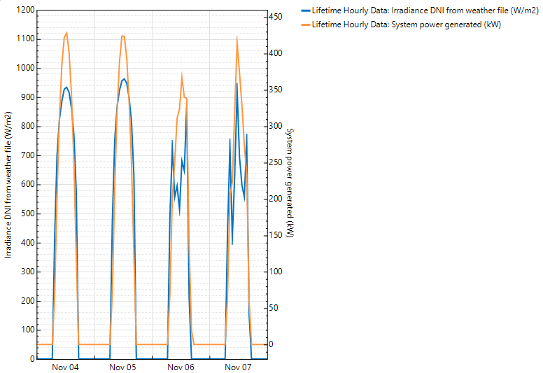

In SAM, the effect of weather on the production of a PV system is determined by the data in the weather file. SAM's PV performance models require a weather file with information about the solar irradiance, ambient temperature, and wind speed. The solar irradiance data in the file accounts for the effect of clouds: The daytime direct normal irradiance (DNI) is less on a cloudy day than a clear day.
To see the effect of clouds on the system's performance, you could compare the electrical output of the system on a clear day with the output on a cloudy day. You can use the "Irradiance DNI from weather file (W/m2)" and "System power generated (kW)" output variables to see this effect. For example, this plot shows two clear days followed by two cloudy days:
