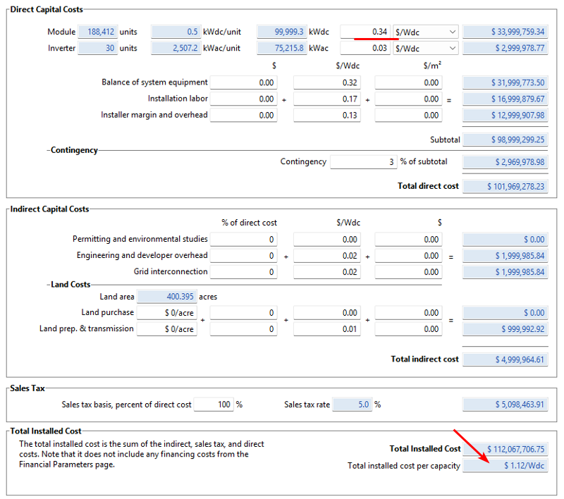

For a PV system, you can change the cost on the Installation Costs page. For example, for the default Detailed PV / Single Owner configuration, the module cost of $0.34/Wdc along with other default costs results in a total installed cost of $1.12/Wdc:

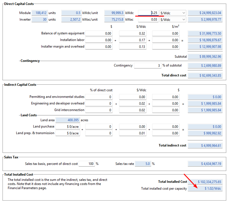

If you change the module cost, for example, to $0.25/Wdc, the total installed cost changes to $1.02/Wdc:
