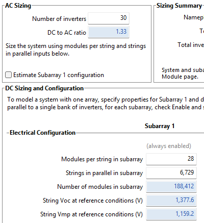

For the Detailed PV model, on the System Design page, the Modules per string in subarray and Strings in parallel in subarray determines the PV array's DC capacity, and the Number of inverters determines the inverter AC capacity.

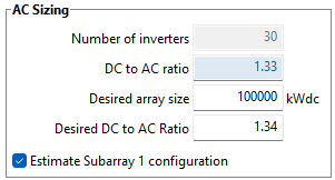

If you are modeling a system with a single subarray, you can use the Estimate Subarray 1 configuration option to enter the Desired array size in DC kW and Desired DC to AC ratio. SAM automatically calculates the number of modules per string, strings in parallel, and number of inverters to get as close as possible to the desired values.

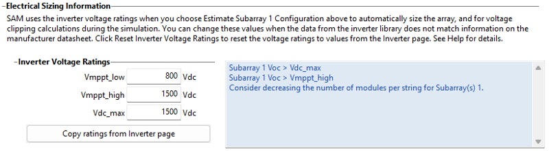

The electrical sizing information at the bottom of the System Design page provides information that you can use to refine these values.

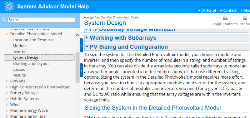

The "PV Sizing and Configuration" section of the "System Design" Help topic has more detailed information:
