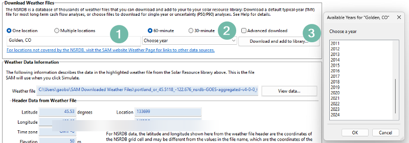

If you are running PVWatts in SAM, you can download PSM GOES V4 files for any year from 1998 to 2024 by using the "Choose year" option on the Location and Resource page:
