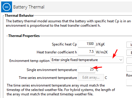

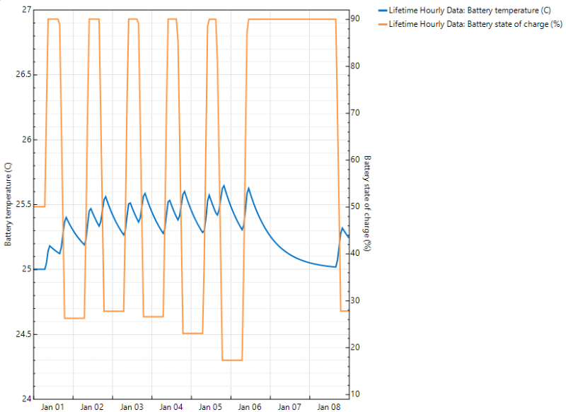

- Gur Mittelman
29 May 2025 05:25 #14083
by Gur Mittelman
Replied by Gur Mittelman on topic Battery temperature
Thanks Paul,
I updated the battery environment temperature to single 25C value and run it again.
The output battery temperature is now very (to) close to 25C in all time steps which is still surprising since during charging or discharging, the battery temperature is supoosed to exceed its environment due to internal heating.
See attached.
See attached.

Replied by Paul Gilman on topic Battery temperature
Hi Gur,
The small difference between the battery temperature and battery environment temperature is due to the heat transfer coefficient, h, under "Battery Thermal" on the Battery Cell and System page. The battery only heats up when it is being chraged or discharged and cools when it is not being charged or discharged.
The default value of h suggests a battery with active cooling that maintains the battery temperature.
In your file, each charge and discharge period is followed by a period of rest, so the battery has time to cool before each heating cycle.
