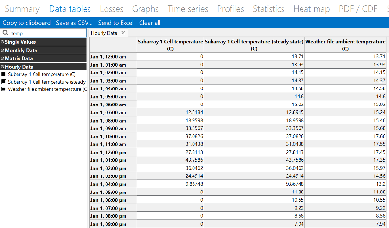

When selecting the NOCT method and observing the Data tables or Time series results, the cell (transient?) temperature seems wrong.
When selecting the heat transfer method and observing the Data tables or Time series results:
- The cell (transient?) temperature seems wrong.
- The steady state cell temperature is identical to the wetaher file ambient temperature (seems wrong).
Attached is the SAM file.
I'd much appreciate your assistance.

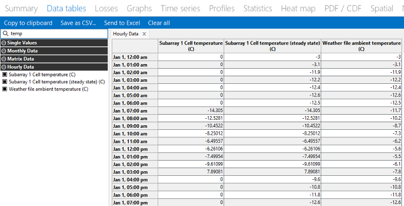

The "Subarray 1 Cell temperature (C)" and "Subarray 1 Cell temperature (steady state) (C)" are only different when you use a weather file with subhourly time steps. The values are the same for hourly simulations.
In my test using your file, the cell temperature is different from the ambient temperature:
I used a weather file from the NREL NSRDB for this test. Please share a copy of your weather file if you would like me to investigate further.

Thanks Paul,
That data you show is for Jan 01.
But it seems that from Jan 04 and on, the cell temperature is identical to the ambient (selecting heat transfer method).
Best Regards,
Best Regards,
