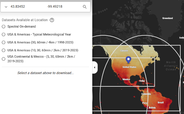

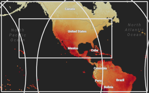

The different datasets cover different parts of the world. You can use the NSRDB Data Viewer to see what datasets are available in different parts of the world. However the NSRDB Viewer uses different names than the API documentation on the NREL Developer Network at developer.nlr.gov/docs/solar/nsrdb/ , so it can be tricky to identify the datasets on the map.
Both the PSM V3.2.2 and GOES V4.0.0 datasets cover the rectangle that includes much of North America, Central America, and part of South America:
The location 43.83452,-99.49218 is in the U.S., so is covered by GOES V4.0.0, which is labelled on the map as "USA & Americas (30, 60min / 4 km / 1998-2023)":
